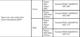

Attached screen shot from 2019 Ryker on-line manual
2020 is the same
2020 is the same

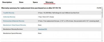

So, should I go for the 22,500 mileage warranty?!
BTW: Stock tires on my 2002 H-D Sportster 1200 Sport were the very soft Dunlop K591s, not the Rocklop 401 or 402 on most Sportsters of that vintage. Trying to remember if original rear lasted 3,000 or 5,000 miles.
