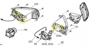

Billybovine pegged it, I think and Lamonster's video confirmed it, I hope. If you watch carefully...
I'll have to dig into it either an evening or, more likely, this weekend early when it's still cool.
UPDATE: Circled another after looking at Billybovine's diagram.
