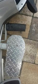

Hello. I just purchased a new 2013 ST-S SM5. I still have my 08 GS SM5. The only thing that I don't like about it is the driver foot pegs. I'm a handicapped rider and I prefer to have my feet on a solid surface that's the length of my foot for personal comfort. Has anybody found or made a replacement for these foot pegs? Thanks in advance for any information that you can provide me.

The ST also comes with floorboards for the SE5, not sure how these would go with a manual.
I have an Rt that I made a set of footboard for And I imagine it could be done for your bike. It is supported from underneath with 2 steel mending plates.
