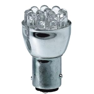

I had several LED replacements for the 1157 bulb, I had replaced the license plate housing with a cats eye housing and put a LED in all worked fine.Then I thought wonder what will happen if I replaced the running- brake lamps also. I replaced one checked lights all was well, when i replaced the second one I got a traction control fault engine fault and went to limp mode. I know they are lower amperage. Put the two old 1157 back in and all was well.Talking about finicky!

When you replaced the 1157's with LEDs The computer read that both tail lights were out.
LEDs = less power draw. You would need a resistor in line to fool the computer and make it think it was drawing more power like the 1157's

You CAN put 1157 LED bulbs in the taillights if you use the right kind.
I've had LI-1157RCZ bulbs in my Spyder for over 2 years with no problems at all. They have the proper load equalizers to fool the computer. :thumbup:

Pilot 1157 bulbs
Bought these lights. They work fine. Available at http://www.amazon.com/Pilot-LI-1157...PTU6/ref=sr_1_7?ie=UTF8&qid=1317313245&sr=8-7 and other places

I used the Pilot LI1157RCZ and they worked fine for 3 months then one side lost the running light portion and I went back to regular 2357 bulbs because I can get 6 Pair of them for the price of the Pair of Pilot.
