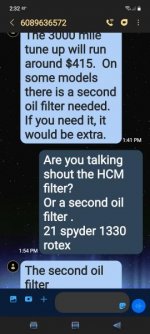

I got a text on the price of the 3000 mile initial service.
What is he talking about a second oil filter.
Did I miss something?

Yeah let us know please.
I have only change one oil filter on my 1330 , the HCM would be the other , but that dont get done till 28K I believe.
There are 2 oil filters on a 998 VTwin, But I thought only one on the 1330 plus the HCM filter. He May be confused:dontknow::popcorn:
I guess one could give the bloke the benefit of the doubt because, at least with the 2013 RT that has a V-twin, the maintenance schedule calls for replacing the HCM filter at the same time the oi filter is changed.
It just says 'IF'. I think it is a generic notice that depending on your version and the mileage, there may be additional filters required. At 3,000 miles on a 1330, there is only 1 filter required. If they try to get you for an HCM filter, I would not pay it.
