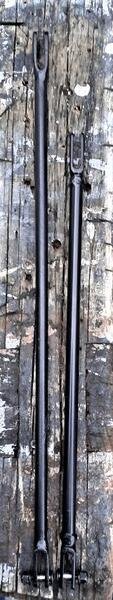

I made my own. Not really a good welder but managed to get it to stick. haha
