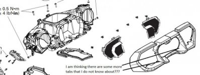

in the multi-function gauge? This is on a 2017 F3L. Pulled on the top plastic along the seam and the clips behind let go. Pulled on both sides near the mirrors and the clips let go. Also, the tabs on the bottom by the speaker grills let go. However, there seems to be something holding the center bottom from letting go. Any ideas??

and here I thought it was a PITA to get the lens out on my F3-S! FWIW, there are both types of tabs on mine. Ones where I need to pull them outward away from the gauge/lens assy, and some where I have to push in! :cus:
Just have to pull harder - the clips on the bottom will let go. I had the exact same issue/concern. Mine finally did come off, but it definitely took some effort!
