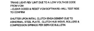

Can someone explain to me why this wasn't taken care of when I had my clutch repair/replaced under warrantry? I mean, while you are in there, have a look around for other bad parts? Duh!
This is from the dealer. They are talking $1100 to fix. I think they are trying to see if BRP can take care of it?
The bike didn't ever 'shutter' before the previous repair but it does when I first take off after starting. I do let the bike warm up a bit.
I have been getting the dreaded orange transmission warning on the cluster a few times. I check the oil level and it's fine. I do the 'pull the key and walk away routine' and it clears each time.
The other day I put it in first gear and got a crunching noise I've never heard before. Popped it back in neutral real quick!
Any help, thanks!
Service bulletin? Wonder if that's the bulletin that dates back to when they made a change in the clutch plates and clutch oiler tube length?
