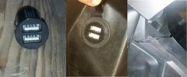

Why not just plug into the 12V outlet in the trunk? It is most likely already protected by a fuse and much closer to the passenger than the battery. When I needed power to my GPS or phone between the handlebars, I just ran a 10' USB to mini USB cord tucked into some creases in the backrest padding then under the panels under the seat and finally up to the handlebars. It's neat clean and a no muss, no fuss installation. The only thing I really had to do to the Spyder was cut a small notch in the rim around the top of the trunk so the wire did not get pinched when the lid closed. I'm betting you could do something similar with a standard accessory plug with the proper connections for the heated gear on the other end. I'm sure someone will be horrified that water might get in there, but it all fits so well and is protected you would have to be driving in hurricane level down-pours to worry about that. I've driven in some pretty heavy rain with it like this and had no water get into my trunk.

Check the fuse rating on that plug as most heated gear draws more amps than that. I run a separate fused wire that is 12 to 14 gage from the battery to a powerlet plug. This way I will not over burden the wiring, and since I cannot leave the Spyder an still be attached I'm not worried about draining the battery. If I have a possibility of having something that can be attached to it when I'm not there (heated seat) I run the same gage wire to a relay that is powered from a wire that is only powered when the bike is running. This safely provides the wattage needed without the possibility of draining the battery.

Granted, I have not checked the fuse rating on the plug in my trunk, but I do know it is not powered unless the bike is running. Mine is a 2014 RTL. Have no idea how the newer ones are wired. Then again, I'm only using mine to power a phone and occasionally a GPS. Since I retired, I avoid riding when it's cold enough to need heated gear--retirement is a good gig when you can get it. :ohyea:
