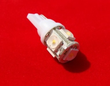

Just installed my $3 total for both SHIPPED :2thumbs: from ebay LED bulbs from Hong Kong. Easy to install. just pull out old incandescent bulb and plug new... if they don't light rotate the bulb 180 and plug in again. They are 5 LEDs/bulb and fit nicely in the fender. there are 5 LEDS. up/down/left/right/top facing on each bulb. the fender light just slides up and then you lift bottom of lamp housing and pull out slightly and slide back down and it will pop out. then rotate the wiring housing and you can get to the bulb. the lens comes off.
The incandescent bulb was a yellowish white. these are more toward the bluish white then the LED accent bulbs on the RTS. but since it is blue spyder not bad. plus the oem bulb gets really hot in the small fender enclosure and uses more energy obviously.
The new bulbs are about the same brightness as stock but from on the bike easier to see so depends on angle if you are inline with one of the LEDs it maybe only slightly brighter.
