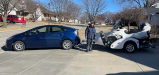

I would think one of the considerations is how you tie the Spyder down.
If you're attaching the tie down straps to the Spyder's frame or handlebars then yes, I'd be worried about the trailer's suspension.
But if you use tie down straps through the wheels then the Spyder's suspension will take care of any bounces.
Fair warning: I have a Stinger trailer.
