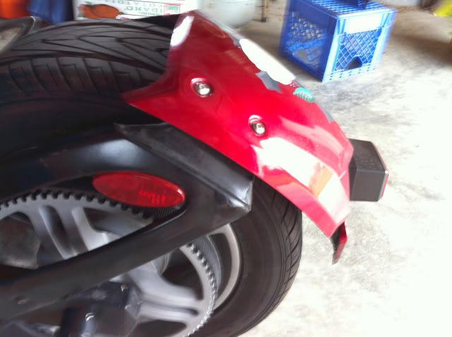

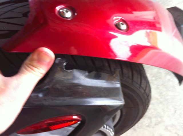

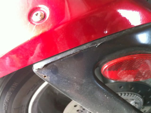

dltang is finally going to be going without a back fender, not because of her desire for the look but because we have had the worst luck with those rear fender brackets on both of our Spyders. Here's what happened to hers this past week....
This was her second set of fender brackets and I've repaired the bracket mounting tabs on the swingarm 3 times on each side also. :gaah:
Wow. I have seen more and more of these brackets fail. I would love to see BRP replace the metal fender with a fiberglass or ABS plastic upgrade.
Sorry about your fender.....Did BRP jump to the pump on this or was it not considered part of the warranty?
I fixed my left side and I just noticed my right side is doing the same thing. I think in my case it may be the heavy Corbin fender but it could just be bad roads as I was in Canada and those roads were pretty bad. :dontknow:
I'm on my 2nd set as well and for what they do I think they could make them out of plastic or fiberglass as the metal seems to fatigue after awhile ?:dontknow:.

Mine cracked along the same lines as yours, as well as having the swing-arm tab on the exhaust side break off.

I think these could be reinforced so that they would not break very easily. That would involve completely stripping them, first. Better to do it with a fresh bracket, and not a cracked one. It would also require strengthening the attachment tabs on the swingarm. JMHO
Tough nut to crack, from an engineering standpoint....a cantilevered bracket, with an attached weight (fender/light), that is not sprung or suspended, and takes every jolt the road can provide. Stamping the bracket, which creates stress points, does not help. I think it could be overcome, though. They could use Michigan roads for testing. We can give Canada a good run for its money.

Someone suggested to me that a probable cause is the retaining bolts getting a little loose over time and causing vibration in the holes and putting stress on the bracket. Not loose enough to notice, but loose enough non-the-less.
