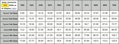

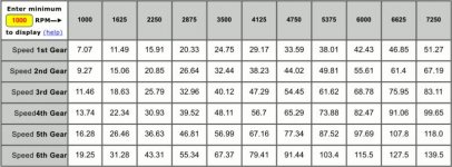

I wonder if the (North American) ECU would accept the 79 tooth rear pulley and the RT belt without throwing a fit?
If my math is correct that would be an 11.2% increase in gearing so 55 MPH would be 2857 RPM instead of 3219 RPM.
I could live with that.
