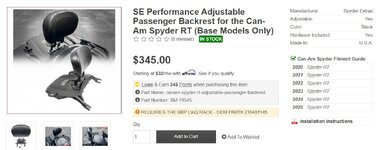

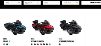

The 2022 Base RT did not come with the passenger back rest, as shown from the Can Am website. Backrests can be purchased from Can Am or Slingmods. Of the 2, Slingmods is less expensive, but both require the BRP LinQ Rack - OEM Part# 219401145, which is another $400.
2025-09-25 RT Base.jpg-
2025-09-25 Can Am passenger back rest.jpg -
