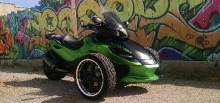

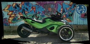

New wheels and tires. Fronts 205/40/17 on 17×7. Rear is 225/////60/////15. Now the speedo is totally accurate per GPS and the bike is so much more stable and supple. Super happy! Not sure how much lower it is revving at highway speeds but it is noticeable. Front width is now 62.5 inches with the adapters and wheels/tires. Also no nanny issues or clearance issues!!!
