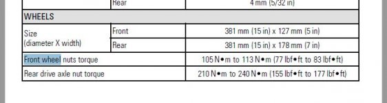

2014 RT, anyone know the lug nut torque (front) please, Thanks, Chris
This is from the service manual. In case you haven't done so already we forum members highly advise you to get one if you expect to do work on a Spyder. One source is canammanuals.com. About $30 for PDF download.
Thank you so very much, I did set them at 90, so I may reset to the lower number.
