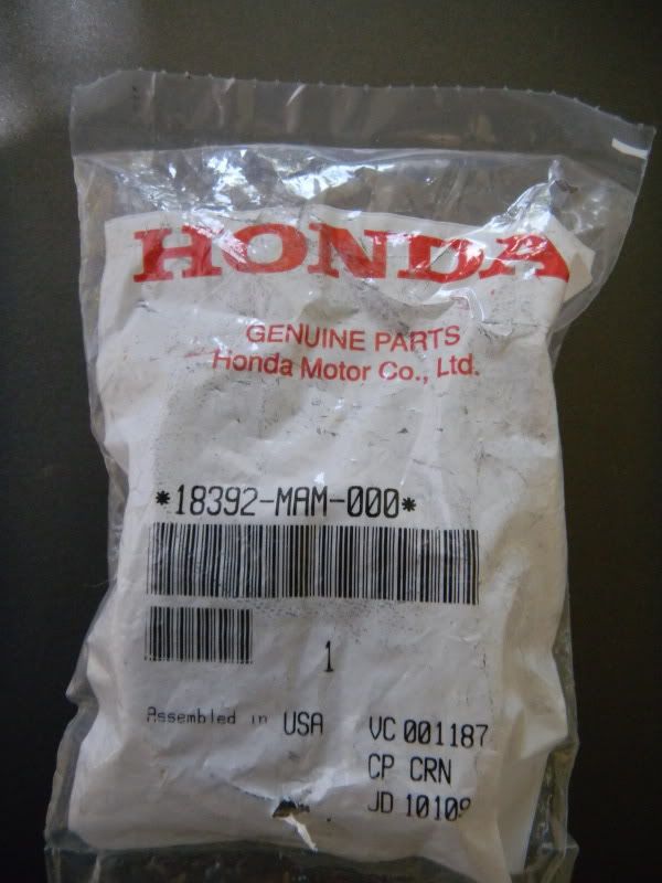

I am thinking my exhaust gaskets may have played out -- I had them changed at 6K. Dealer did the work and used BRP gaskets for replacement. I now have almost 17K. (08 SM5). The spyder is running good just the popping - Is this the exhaust gaskets or should I be looking for something else too?
My first thought is that the BRP replacement gaskets are shot once again. This is why many here have gone to the Honda gaskets. The other thing that comes to mind is that fuel can do funny things when it gets hot like that. Does it do this under more mild conditions as well? When was the last time you had your machine serviced? Might be time for plugs, wires etc...
Have had all the scheduled maintenence last oil change and service at 15K. Full 12K check was also done at the dealer.
I figured it is the gaskets and I have the part number for the Honda's - I will start there and I will see. As I said the spyder is running great except for the popping. Got better gas mileage out of that tank and it ran cooler too.
If your first set was toast at 6k then one can expect them to be toast again by now. Go with the Honda ones and be done with it.
