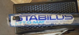

Nightcruiser - can you provide information as to model number on the Stabilus strut that you photographed? That would be helpful. Thank you.

I ordered this item from Amazon, and it fit perfectly. It has more lift than the OEM but not too much as to be problematic. Literally, just plug and play. All fittings are same as factory took less than 5 minutes to install. The Amazon details are, SACHS STABILUS GAS SPRING WINDOW (SG359011). I would order it again if I needed to replace for any reason.
