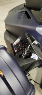

Yes I have. I used a Battery Tender extension, threaded it on the right side over water reservoir, zip tied to upper frame back to seat.
