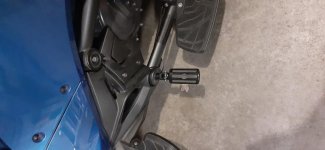

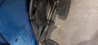

A bum hip (osteo arthritis) makes getting on and off my F3L agonizing and difficult. Since my rider boards are way forward in position #4, I can't use these boards for mounting. So what I do is place my left foot on the passenger board, toss my leg over the seat and achingly ease my way into the saddle. Not a pretty picture to those observing. Dismounting is equally frustrating.
Eyeing the fixture (don't know its name) at the aft end of the bar that supports the rider's board, I thought that's an excellent location for a peg that can make it easier for me to mount and dismount. With no modifications to my bike, save for a longer bolt that replaced the original, here it is, thanks to a Harley used parts store. Oh....and a hip replacement is in the works.

I spent all of $1.83 on the peg project. The used Harley parts store gave me the peg and adapter because it was old and they only had one. I only wanted one for the left side, so that was OK. At Ace Hardware, the bolt was $1.50 and a tension pin was 33 cents. The satisfaction of working it out myself - priceless.
Placing the peg in line with the frame cap gives me the exact height I need to be able to throw my right leg over the saddle.
