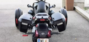

to make it "easier" you could buy a rack with cases from Shod or GIVI - if you dn`t need the passenger seat it should be easy to adapt the parts to the max-mount, I use a Version for the BMW S 1000XR with the smaller SH23 Cases from Shad .. one U-bracket over the maxmount und two brackets from the frame to the lower points of the rack .. should not be a problem to make them.. (the Set from Shad with the BMW- brackets is around 350,- )
