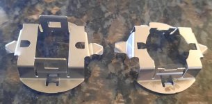

3. Had to slightly alter the locking rings to accommodate the new lights using a Dremel (see photos--left original/right modified). NOTE: The Tab on the retaining ring goes DOWN--start it about 4 o'clock and turn to 6 to lock.

View attachment 199089 View attachment 199090
View attachment 199092 View attachment 199088
