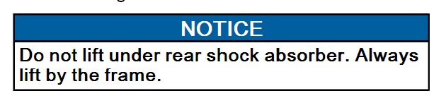

Now to a jacking point, is it OK to jack just in on the frame in front of the CConverter?

No OBD plug. Software is proprietary to BRP. Have to buy BUDS2 program. Yes jack right there on main frame. Sometimes I jack on rear shock using block of wood between it & jack. Many places to buy service manual.
Thanks Woodaddict. Any reason why you would choose the shock bolts versus the frame?
OK, I'll look online for the manual; it's always good to have one, new Spyder or not! I spent my life turning wrenches and I'm always curious to learn how things work. Thanks for your post.
The shock just gives a little more weight to front for balance. I do rear tire changes this way
