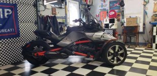

i purchased my 3rd SPYD3R in Dec. 2019, she's an F3-S SE6, 1330...
currently have 1500 miles of smiles on her, and am planning a multi-thousand mile ride...
QUESTION: since the 1st oil change is at 3000 miles, does anyone know if i should wait, or will it be ok to change it sooner than 3000 miles...

I'd definitely change oil. You don't say what year your F3 is, but from the picture it looks like a 2015. That oil has been in there a long time. Age of oil can be just as detrimental to the engine as miles.
Looks like a 2019 F3-S SE (top picture). If a lot of your trip miles are going to be freeway, I'd say it'd be ok to let it go to 3500, as highway miles are pretty easy on oil. If a lot of back road stuff, change it before you go. Just my .02 :)
2019 is the new one....
bottom pic is of my old 1... it's a 2015, and i traded it in for the '19 with 64,000 miles of smiles on her.... treated me EXTREMELY well for ever mile.....
Weird, when I posted my response in post #2 the picture of your '19 wasn't there, just the picture of your '15. I still think I'd change it if your going a lot over 3000 miles on your Spyder on your trip.
