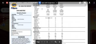

Just got back the oil analysis and found that iron had went up by quite a lot. Went from 46 ppm on last sample. This one was 258 ppm.
Is the clutch going South?
What are everyones' thoughts?
I will post the report when I get to a big computer. This laptop is pretty limited.

I will retest at a shorter interval. And, I will draw from the dipstick hole, rather than the drain. If it continues high, I will get it to a dealer. Much easier to fix something before it grenadeds. Also, the oil is M14T 10x40 and I use the dealer oil filters. Thanks for all the responses.
