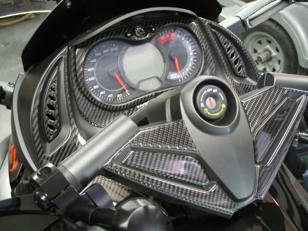

The importance of test fitting each part is key. The installer should be very familiar with the exact fit of each part before removing the protective backing. Use care not to apply 3M Adhesive Promoter to any section of the dash that will not be covered by a part as staining may occur.

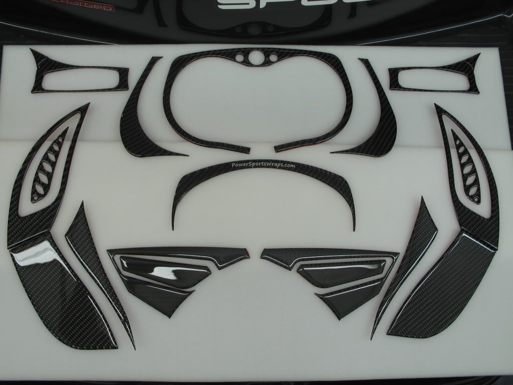

Here are all the included parts:

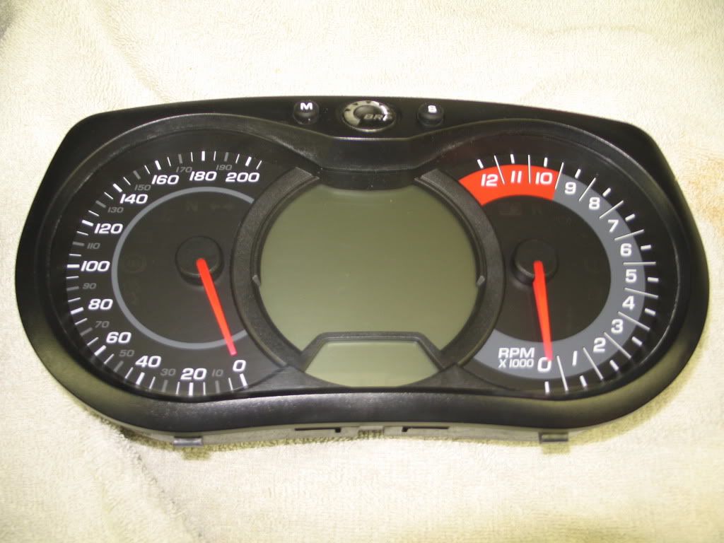

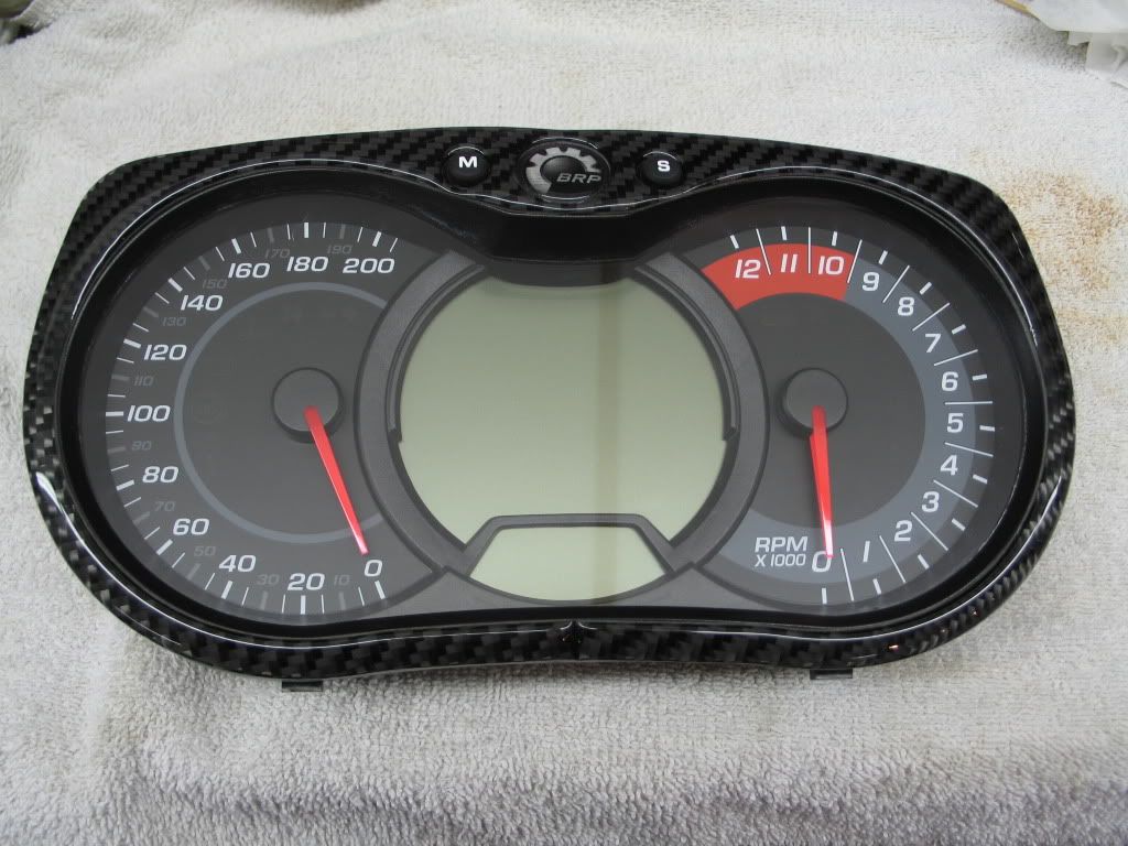

The Display Console on a GS/RS Spyder is easily user removable. Instructions to do this are included in the BRP owner's manual as it is necessary to remove it to change the headlight bulbs.
It is much easier to apply 4612-05 Part-5 with the display console removed:

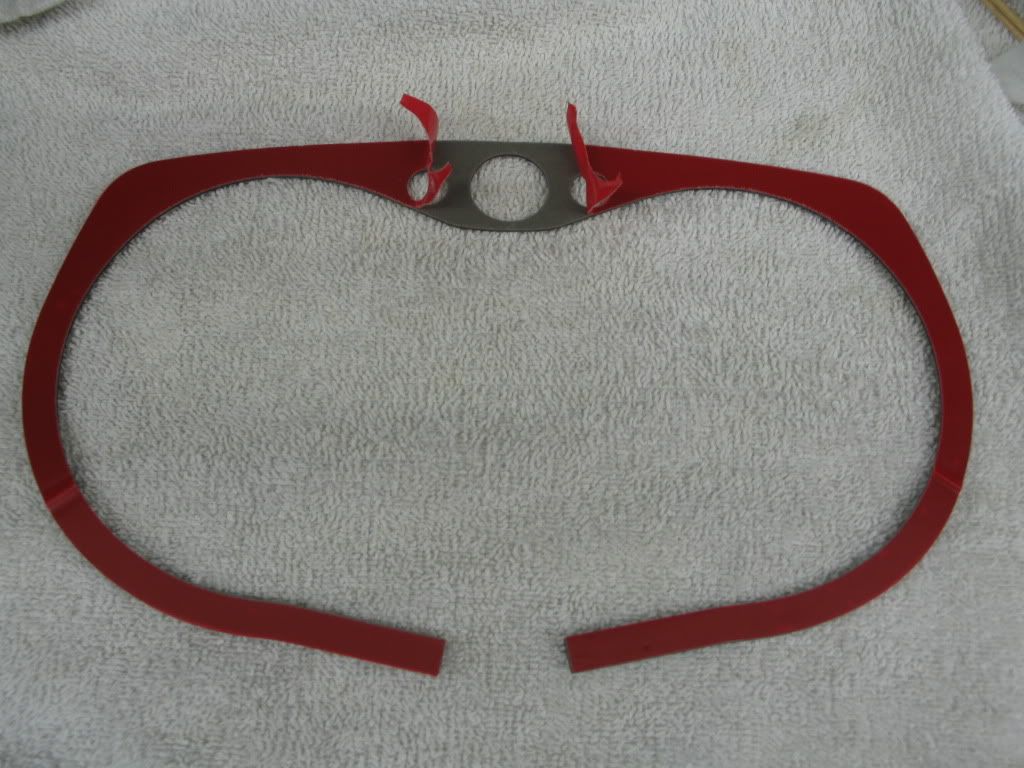

However this is not required and the part can be installed with the display in place. Installation of Part-5 should begin at the BRP logo and button area.

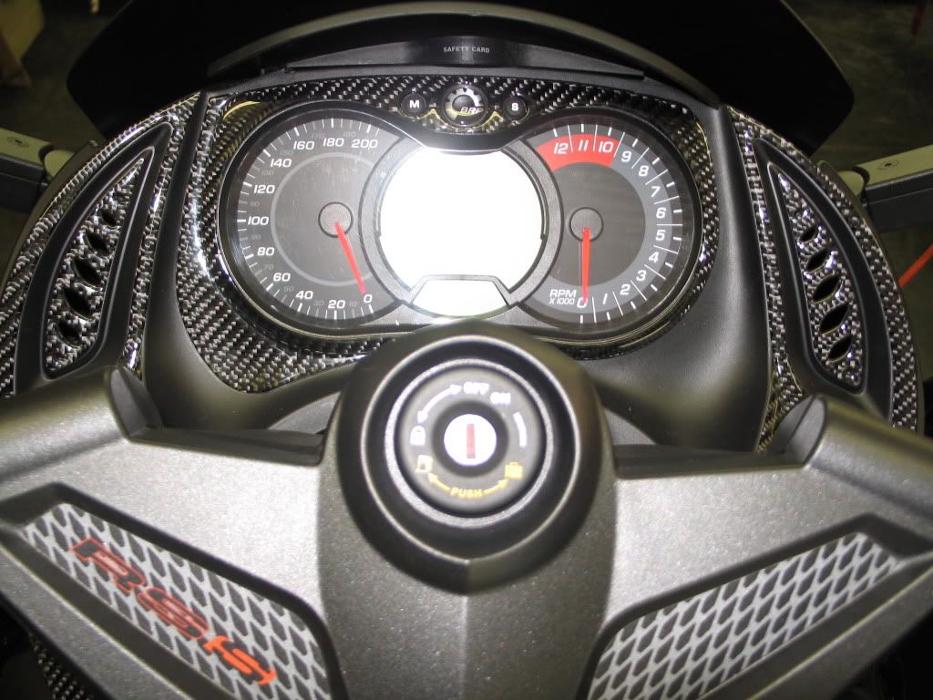

Peel away only enough of the protective backing to carefully center the part over the logo and buttons:
Then, gradually pull away the protective backing on the left side only carefully centering the part until the entire left side is adhered.
Next remove the protective backing from the lower section of the right side only and adhere the right half next to the left half.
Then, gradually removing the backing as you go, adhere the remaining section moving upward toward the top of the display.
If you try to adhere the right section from the top, the two lower halves may not join together and a gap may be present in the lower center of the display.

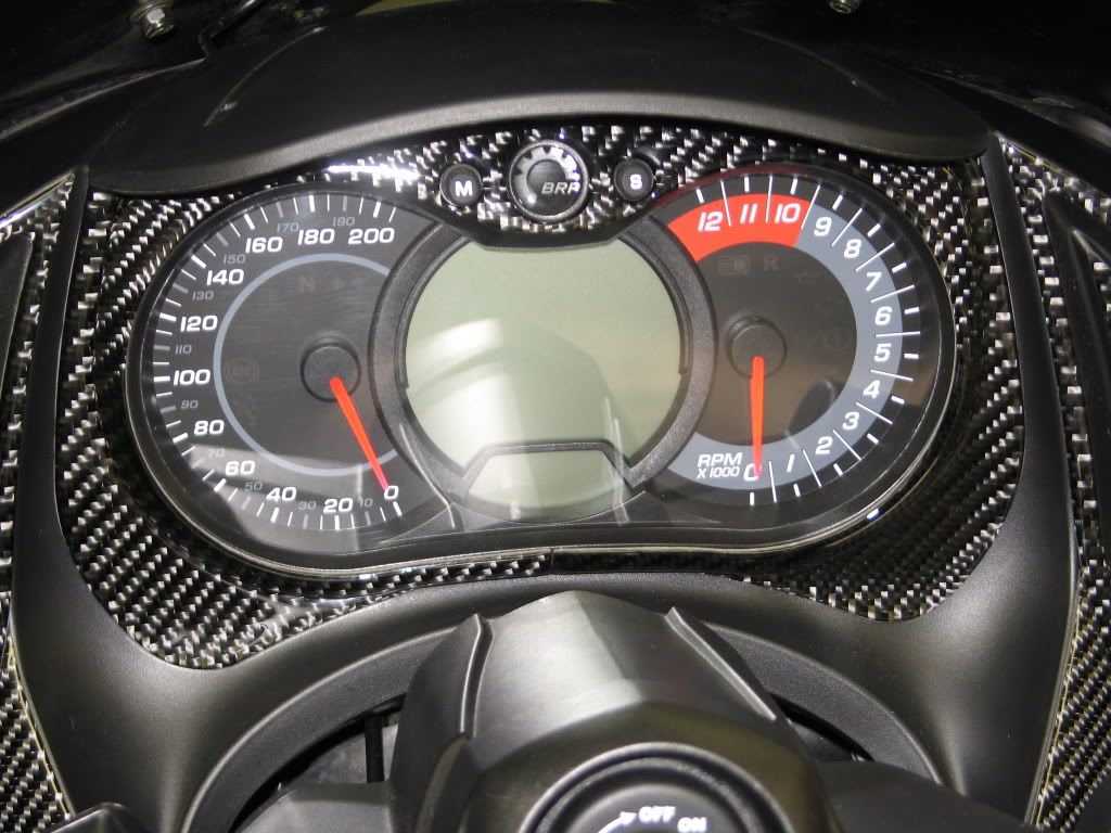

If done properly the results will be excellent:

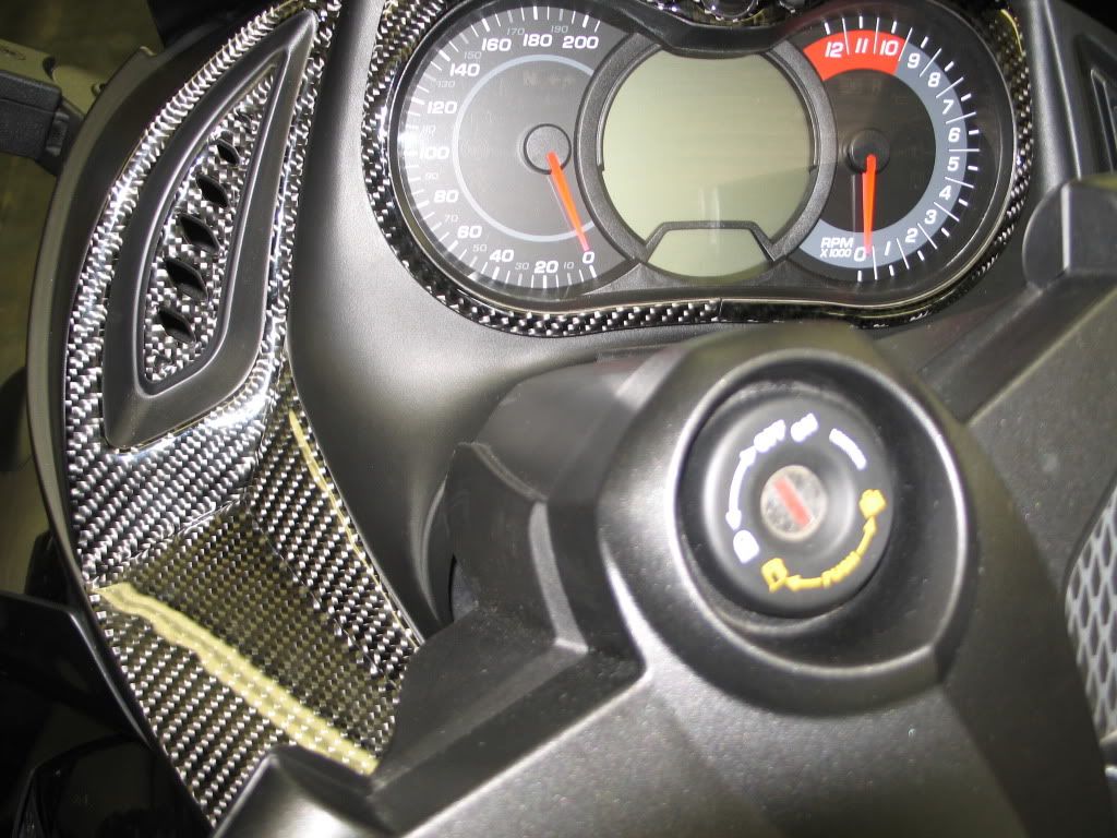

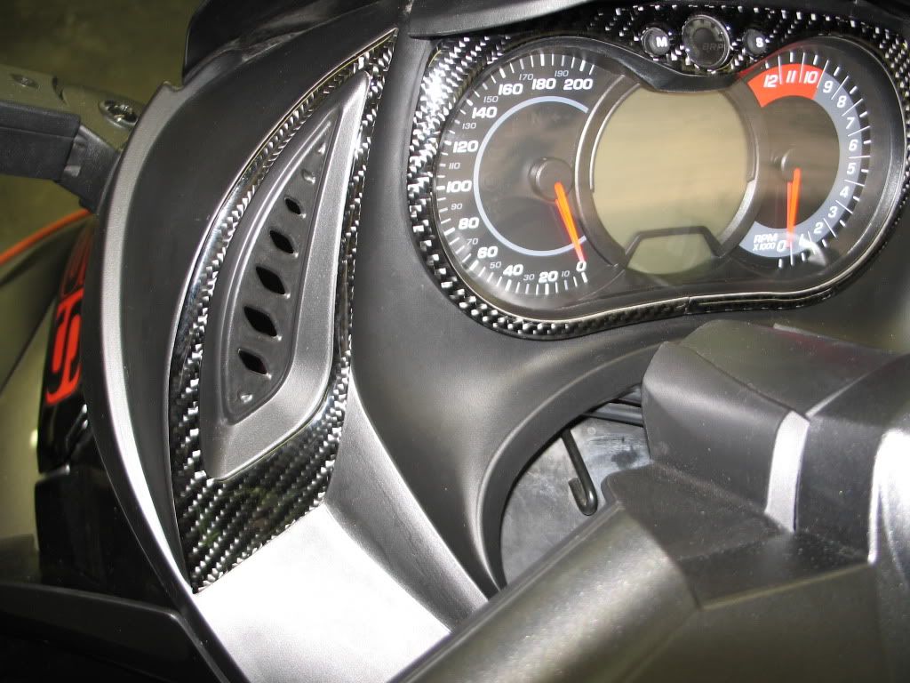

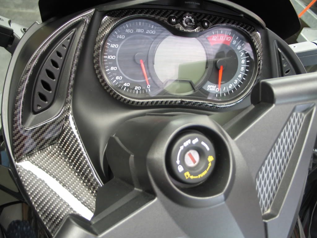

4612-11 Part-11, 4612-13 Part-13, 4612-19 Part-19:
These three parts combine to cover the left side of the dash console. They must be fitted together precisely for a proper fit.
Start by taking all three parts together and perform a test fit to see exactly how the parts align:
Move all the parts around until the best alignment is achieved. At that point remove Parts 13 and 19, leaving Part 11 in place.
Using a pencil, mark a line under the bottom of Part 11:
Adhere Part 11 first, using the pencil line as a guide. Do not try to adhere the part all at once, rather remove the protective backing only from the
bottom so you can still maintain alignment of the top without yet adhering it. Align and adhere the bottom only with the pencil mark and then,
working toward the top, gradually remove the remaining backing while carefully aligning the part.
With Part 11 now adhered in place, once again test fit Parts 13 and 19.
When the best alignment is achieved, remove Part 19 and mark a pencil line along the right side of Part 13:
Remove only the upper protective backing of Part 13 and align it with the lower end of Part 11, then gradually remove the backing while carefully
aligning it to the pencil mark. With Part 13 now adhered, carefully install Part 19:

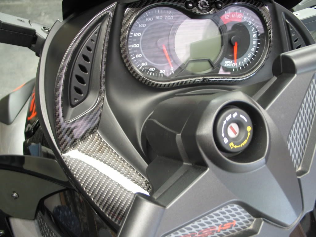

Repeat this procedure for the equivalent right side parts (Parts 12, 14, and 20):

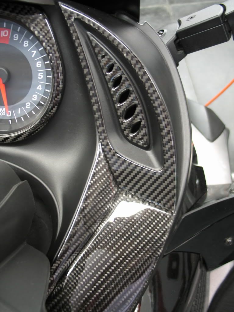

4612-07 Part-7:
When preparing the surface for Part-7, use care not to apply 3M adhesive promoter to any section of the dash that will not be covered by the part.
Test fit Part-7. When the best alignment is achieved mark a pencil line around the bottom of the part. Remove the backing from the lower half only
and carefully adhere it aligning to the pencil mark while holding the top half in place.
Now remove the upper half of the backing and adhere the top of the part in position:
Repeat this procedure for Part-8. Follow a similar procedure for Part-6:
The remaining parts can be installed after a test alignment without difficulty.
