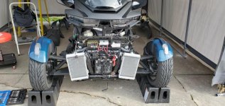

First things, first. Run the bike up on a set of ramps. Trust me, unless you can fit in 3" of clearance, you WANT to do this. Standard ramps are fine. You only need to get to a couple of bolts that sit to the rear of the plastic skid plate. Unfortunately, those bolts are in a recess and can't be seen from the front.

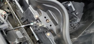

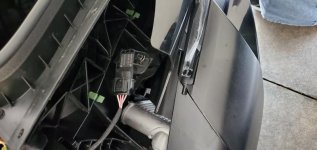

Before you remove any bolts for the front clip, you need to unplug a few wires. The shop manual says there are (5) of them. Some of them are dead ends. I had (2). One on the right side connected to the ambient air temp sensor...
...and one on the left side going to the Auxiliary light. There's another capped plug tangled up with the Auxiliary plug that (I think) is for the Limiteds Signature lights. I'll test this to be sure once I add those later this year. (NOTE: if you start the bike once you've unplugged the ambient temp sensor, you'll get a couple fault codes.) Also NOTE, if you have anything hooked up to the battery that runs into the frunk, remove the cover/unwire it now. (I have an SAE cable for a batter tender and didn't think about this until I was holding the entire front of the bike in my hands and realized I had to temporarily remount it in order to take the battery cover off.) You'll also have to unplug the BUDS cable from its faux port and tuck it out of the way.

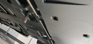

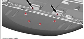

Next, you'll need to remove the the (2) bolts under the bike THEN the (4) bolts just under the headlights. These are all 10mm. I used a short extension on all of them. Now, you'll need to remove the frunk lock. Again, 10mm bolts and Nyloc nuts. (BuRP calls these elasticated somethingorother and says you should replace them. Don't listen to BuRP.) The bolt heads are easy to get to. The Nyloc nuts, not so much. If you drop them (now or when you're reassembling), they fall into odd places. I wrapped a piece of tape around an index finger and stuck the bottom of the nut to the tape. Worked well. Again, I didn't think about this until I was REassembling the part and kept dropping the nuts.) NOTE: the spring isn't going anywhere. It's captured by something on the underside. NOTE: once you've removed the bolts, DON'T lift up until you're ready to remove the front end. There are a couple of tabs the front hangs from. Handy. Would have been handier if I'd realized these were there BEFORE I was reassembling everything. Happy to be your guinea pig.) The 2nd pic shows where the (2) underside bolts are. One is just to the front of the drain line. The other is in the matching recess on the other side of the bike. You can see where there are (2) pieces of metal going from the cross bar of the frame to the plastic skid plate. That's what the bolts thread into.

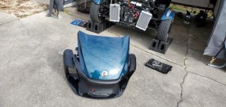

NOW, you can lift off the entire front end! The easy part's done! What you should see is this.
You'll want to put your newly detached front end on a nice, big, scratchproof workbench. I'm fortunate enough to have the latest Washerdryerlator work bench and the Towel2000 anti scratchproof cover. Now comes the fun part. There are a bunch of bolts and push pins you'll need to remove in order to get that stupid ring off the top of the frunk. The top of the liner goes under the ring but over the main section unlike the previous generation which just went under the gasket. The good news is that the Velcro is pre-mounted on the main section.

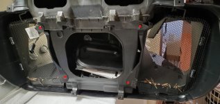

Put the shell aside. You're done with it. What you should have left is the tub and the color matched cover. There's a long bolt that goes through the hinge on the cover. 10mm. Remove that and set the cover aside. Now, remove all the push pins you can find on what's left of the tub. There are quite a few and some of them are well hidden. (way to go, BuRP!) Might be (6) or (8) of them, I can't remember. You'll know when you've gotten them all when you can remove the ring from the tub.
For reference: A=ring which sits on...B=top 1/2 of tub which is permanently attached to...C=bottom 1/2 of tub. D=shell
