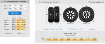

If you used a tire size calculator to work that out, it's not necessarily correct - those calculators will only show/use the '
nominal size' for the entered tire data; and for most I've tried, their results almost always
do not even
exactly match the OEM tire's
actual size vs that printed on the Kenda's sidewall; plus, there's a distinct possibility that the Altimax is also a tire that doesn't exactly match the 'nominal size' from those comparison chart results, so any tire size calculator comparison may be juuust a little misleading at best! And IIRC, most here report that their speedo's became
more accurate after installing Altimax tires (altho which size Altimax they've installed may be also play a part there??) but if that's the case, then like many others have found, your Altimax may well have a
LARGER rolling diameter and so do fewer 'Revs per Mile' than the OEM Kenda, making the speedo show a speed that's a little closer to accurate and your 'true speed'!
