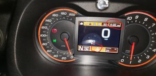

So i figured out how to set the clock, but cant figure out how to view it. The top right hand corner of the screen seems like the logical place, but this only shows how long the bike has been running. I am sure it is something simple i am overlooking
Take a look at a photo of my electronic display at the link below:
https://www.spyderlovers.com/forums/attachment.php?attachmentid=172914&d=1560358589
The time is displayed directly below the MPH indicator.

And does anyone know what this error thing on the bottom is? It goes away once the bike is on, so i'm guessing it's just a test?

Did you buy this Spyder new or used? Not needing to press the MODE button is a "benefit" of having the ECU flashed. Did you have that done? If so they may have set the clock to run time during their setup. And now with a new dash cluster your dealer may have BUDed-up something that makes it display the "Caution Symbol". Does your Spyder still run like it did before being BUDed?
All fixed. The new dash cluster wasn't set right for the shock control. It is fixed now and working like it should. Clock works, shock works, and i don't have a watch tied to the handlebars. :)
