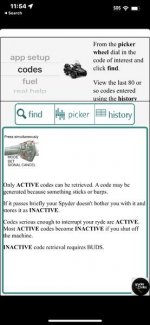

I think you hold down the mode and set buttons on the left handlebar controls and while holding those 2 buttons down push in on the cancel turn signal button.. I think also once you turn the engine off whatever code there was will be stored but not showed on your display.
Yes, I knew the codes would dis-appear after I shut the bike off, I didn't have a choice at the time; but the NEXT time I'll snag them while they are on .... thanks .... Mike :thumbup:
