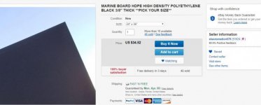

I finally got the time to make a bumpskid for my RTS. I bought the 3/8 inch HDPE on ebay for $35. It was 2 feet by 3 feet before I started. Here is the photo evidence of what I did.

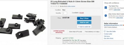

From what I can tell, the OP bought the sheet and temporarily attached it at the back with two bolts so he could trace the outline for the front. That looks to be a fairly straightforward procedure. After that, it's cut to size and smoothed out. And then the other holes are drilled and the U nuts installed and it bolts on. Again, nothing too hard.
I may go ahead and make it out of 1/2" HDPE which might give me enough thickness to route a recess in the front lip and set some LED strips in as well if I feel the need. I just need to source the plastic first then get going. There is a local place in Norfolk that I have used before, and there is always Amazon and Ebay if that doesnt work. Hopefully this should be under 100 or way under depending on what I can find. Should be fun.
