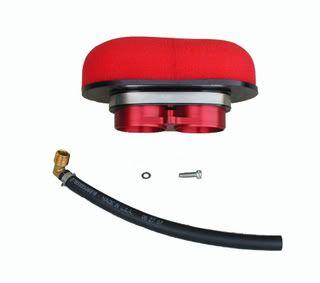

I think this is something like what Way2Fast is referring to. Its Evoluzione's other air filter upgrade. Everyone I've heard of who got this also got Evoluzione's fuel pressure mod and their O2 modifier. Needless to say, they also all had some type of aftermarket exhaust installed before they made these changes.
