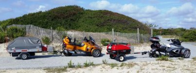

this is my harbor freight trailer I have LED lights, and the brake lights should be separate to be spyder compatable. I extended the rear bumper to carry my 10x10 easy up canopy, it has a tool box and I replaced the cooler with an Igloo 12 volt 120 ac electric because ice is heavy and messy it will carry a lot and tows like it was not there buy the spare tire and grease the bearings before your first trip and all ways touch the hubs with the back of your hand, they should never be hot

Your setup is very similar to what I'm looking to do. Where did you get the car top storage thingie? I'm having a hard time finding a used one in decent shape. Also, I like you electric cooler idea.

The Harbor Freight Tag-a-long trailer comes with the storage box. I was going to post a link to it on the HF website, but it's no longer there; I don't know if they have stopped carrying it or what.
There are other ABS clamshell type rooftop boxes you can buy at different places and just attach it to your HF frame.
This is Amazon's selection, but Sears and other automotive stores usually carry something like it https://www.amazon.com/s/ref=nb_sb_...efix=hard+shell+,tools,172&crid=2SXYFRLCZZAE7
I had the HF Tag-A-Long trailer, it does come with 8" tires which seemed fine going down the road with no problems. You could upgrade and buy the 12" tires and put those on, you will have to upgrade the lights to LED's, and just a side note you can't use the discount coupons on the trailers anymore.

Where did you buy the tray that is holding the cooler?
