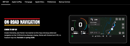

This might be where Android Auto sees daylight on the 10.25" screen. I'm not holding my breath on if or when it arrives, but at least BRP is recognizing that there is a demand for Android Auto. I screenshot this from:
This is only for the electric bikes, NOT Spyders which have Apple CarPlay support instead of BRPGO. Neither bike has both. BRPGO is NOT coming back to the Spyders. This is also NOT Android Auto.
Android Auto is no longer supported or licensed for Motorcycles by Google. Honda and Harley have both dropped it also.
My 2024 RT Limited Car Play is still not working correctly, they have reloaded updates 6 times at least. They have now decided to replace the display - finally, just waiting for parts now. It kept saying Bluetooth Fault on the display...
It really does not work well for anyone. Its a pretty poor implementation that is not stable in use or consistent start up. Most that try eventually abandon it in frustration. The basic bluetooth music interface is pretty reliable however.
As jcthorne mentioned above, in the FAQ section one of the questions is:
CAN I USE ANDROID AUTO ON THE 10.25" DISPLAY:
New on-road navigation features on the BRP GO! mobile app
BRP GO! go was replaced by Apple CarPlay for the 10.25" displays on the 3-wheelers.
The BRP GO! information is here:
BRP GO! can be used on:
- The 7.8" display of 3-wheel vehicles: When BRP GO! is connected to the display, you can use select compatible apps on the vehicle display (through screen mirroring).
- The 10.25" display of electric motorcycles: When BRP GO! is paired with the display, it will offer vehicle information of your Can-Am electric motorcycle right from your phone
*For the 10.25" display of 3-wheel vehicles, Apple CarPlay replaces the screen mirroring features of the BRP GO! app.
