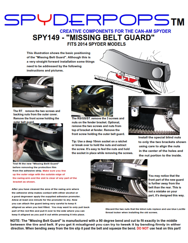

Guard is hard to install
Just a heads up. I received the Spyderpops belt guard just after I stripped a bolt on my Spyder and became really paranoid about working on it. After some looks I decided to have my local mechanic install it since I was brining it in anyway. Even the professional could not figure out how to install it.

The one for the RTs is indeed weird to put on. My husband and I gave up trying to position it so it didn't touch the belt. So we actually cut a tiny section off of it to give it a hair's breadth of clearance.
I have to admit that, as others have said, who knows how much, or if, the guard works. But, for me, it's simply a comfort to know that the big hole that BRP inexplicably leaves in the guard is now covered.
