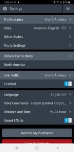

What am I doing wrong? This is on a 2018 Spyder RT Limited. The Phone is Samsung Galaxy S9+. The phone is paired with the Spyder and I'm using the manufacturers USB cable in the frunk. SmartLock is set to unlock when connected to the Spyder's bluetooth. Firmware is at 20.8. I've downloaded and installed the BRP Connect app and the Genius app (among others). Accuweather works, Rever works. Genius maps - don't work. Helpful hints or even "hey dummy" gladly accepted. Thanks in advance!

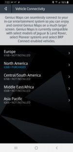

Can you use Genius Maps on the phone? If you can but not on the bike you need to check vehicle connectivity and make sure the fee is paid and if not the purchase can be restored.

The fee is paid and yes, I can use Genius Maps on the phone. I've tried restoring before to no avail. I'll try a complete uninstall and reinstall. Thanks for the help.
