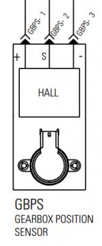

I would disagree. The GBPS is simply a potentiometer. Any dirt or moisture will give false readings. I believe the same part is on both 998 and 1330. A pot is a mechanical device that changes resistance. I wouldn't believe anything can interfere - magnets, RF, etc. On my 998 the part was simply worn - the bushings are junk plastic. It actually rattled when I took it off. Would love to see an aftermarket with a metal bushing & hermetically sealed! High failure rates on this part.

The GBPS is not a simple potentiometer. It is a hall effect transducer. That works by changes in the magnetic field.
