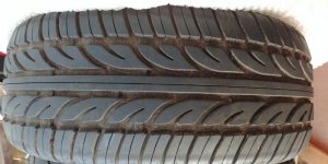

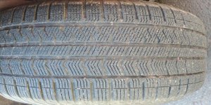

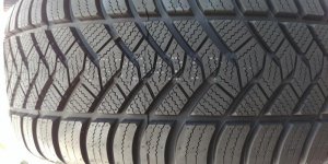

I'll post 3 pictures of tyre treads, you can have a look and see which you consider to have certain characteristics.

Your 3 left to right
1. Wet tyre?
2. Looks like a snow tyre ?
3. Ideal for wheelbarrows (looks like a Kenda)
