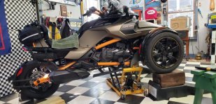

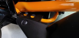

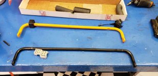

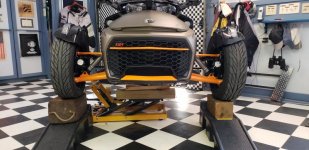

THX to Doc Riverside for his help in providing me with an RT Sway Bar for my new 2019 F3... :bowdown: :clap:
It's amazing how much .050 extra in the diameter of the bar can make while executing the curves in the Blue Ridge Mountains...
It took me a couple hours and a little bit of anxiety to do the conversion, but it was all well worth it... this was my 2nd time at this, my 1st was on my 2015 F3...
NOTE; people have said that you need to get the existing Sway Bar off the floor 22 inches... i found that 25 inches to the center of the front wheel hub is what you'll need... see pix attached... :thumbup:

Just to be sure.
I've measured from the center of the wheel hub to the floor, that's about 10 inches.
So from your measurements 15 inches would be the minimum height I'd need to lift the Spyder from the floor, is that right?
Because I can get a pair of ramps with about 16 inches of height, and that could work.

MAKO;
YES, you should be ok with the 25" measurement.... BE CAREFUL, ESPECIALLY WITH THE HANDLEBARS... DO NOT LET ANYONE TOUCH THEM, THAT COULD CAUSE THE SPYD3R TO FALL, and that's NOT a good thing....
