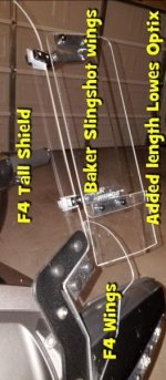

I've had great success with an 11.5 inch (280mm) Moparty extender which you can look "through" between your F4 and itself, but don't put it on an F4 without the braces at the F4 mount (newer model.) Add the F4 hand wings if you want air in the summer. They will give you all the air you need.
I have details here, so "click: to see MY SPYDER PAGE
