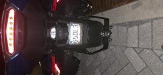

I have a 2023 F3L and the Third Eye. Drilled a tiny hole and mounted it under the license plate. I can take a pic in about 30 min.
Note: they work, but I wind up just turning my head and looking anyway out of habit.
Don't you mean above the license plate? :dontknow: Your pic seems to show it above the plate. Did you mount it on top of the plate light/reflector housing? How has it held up being on the swing arm & having to deal with vibration and the suspension bouncing?

broderp, I like idea of that placement on the license plate light, as jp3zulli shows in the Image; it seems stable and at the correct height per the instructions, but getting wires from there to under the passenger seat is the question for me. I'm hoping that pulling off the top trunk will show me a route; I don't want to pull off the whole rear body work and side bags on my F3 Lts.
I paid someone to install it so I can't answer how the wires got there. The unit itself is under the left service panel. I have never had any issues with vibrations and have never adjusted it in the 1600 miles I have done in the past 7 weeks since getting the Spyder. Also, I did mean 'above'. I wrote the post and then went down to take the pic and added it.
