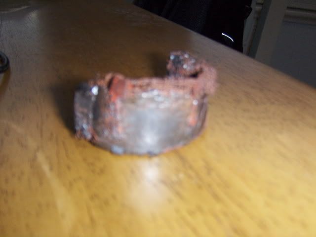

Sounds like it looked quite a bit like mine. I replaced mine myself last week.
So I blew the gasket out hard enough to lodge it into the upper frame. Sounds like HD so sad-----anyway I contact Ted's in Alton ILL.
They contact BRP and order all new replacements parts. Seems there is concern that damage could occur in replacing just one gasket. It will take a few days to arrive then call to check on the parts and make an appointment.

Is there more than just the one gasket where the muffler 90% & header clamp together? :dontknow: Because I have a rattling in the exhaust pipes where they clamp together. I tightened the bolts till I was afraid they would break. It helped a little bit for a little while then back to the same. The dealer also tried tightening them. When you wiggle the pipes you get a movement at the joints where the clamps & springs are. So is there a gasket at that point? :dontknow: This makes the old Spyder sound tinny.
Yep there is a gasket at all those joints. When the service guy replaced my bad gasket, he also replaced the other ones (3 total) just in case they were on their way out.
