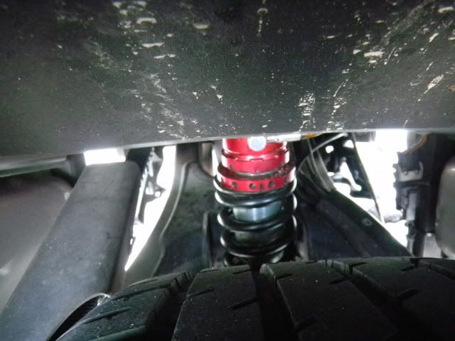

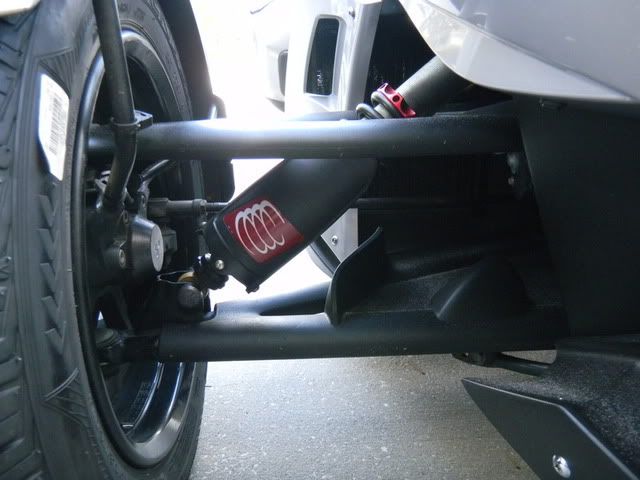

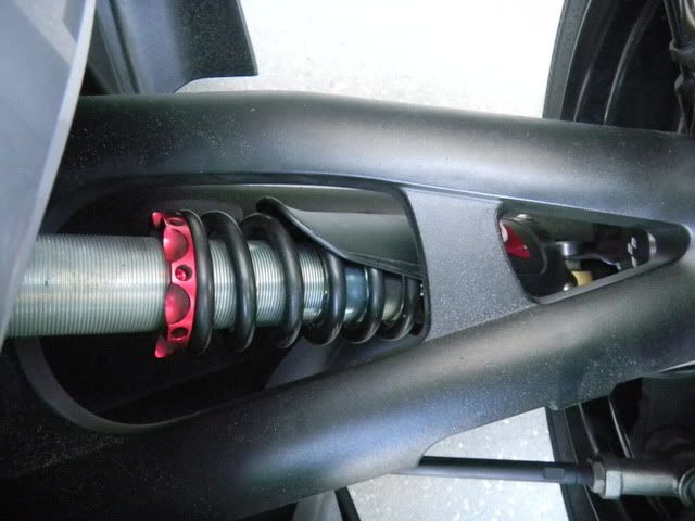

After 80,000 miles (see http://www.spyderlovers.com/forums/showthread.php?t=9158&highlight=elka ) I send the shocks to Impact Solutions in Parkersburg, WV for full servicing: rebuild, oil change, refurbishing and tuning/revalving. Fast (2 days) turn-around, call conforming the package arrived and send, call from the mechanic in reference of tuning...in other words impressive service! Results: my Elka's are like brand new!

This is what I order:
Can-Am Spyder, RS SM5, 174pnds, aggressive street rider.
Front shocks are single rate spring set-up with remote reservoir, high / low speed compression with rebound. Rear shock is a remote reservoir dual rate spring set-up with hydraulic high / low speed compression and rebound adjustments.
