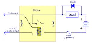

Suppression across contacts/load:

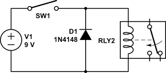

Suppression across relay coil:
One protects the 'relay 'trigger' ( e.g, whatever's driving the relay coil); one protects the contact / load. BackEMF is very bad juju.
Possibly overkill in this instance, Unless one is implementing a huge airhorn compressor, lol. But - the magic's in the details. Guilty. Use a 1N4007 ( 1 amp, 700v PIV ). Stout.
