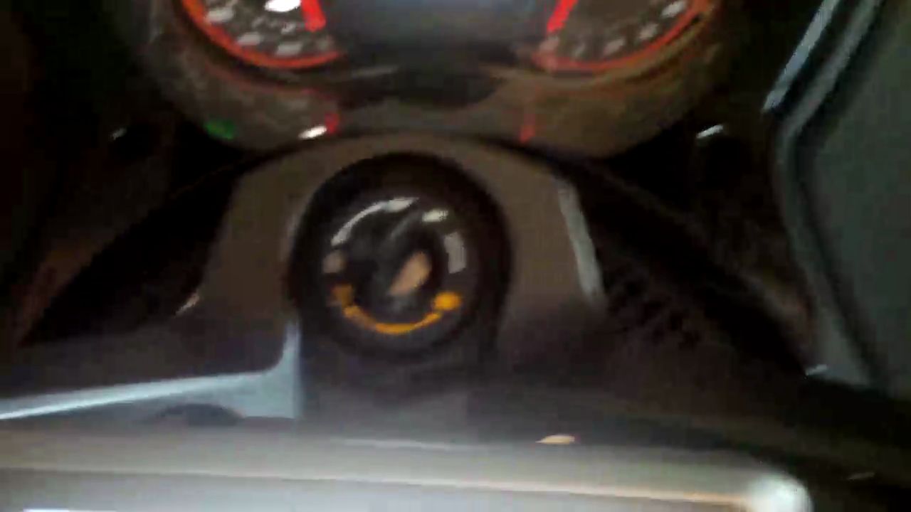

The DESS does not look for the key when the ignition is turned off. Just think about it why should it. The only time the DESS sends out an electromagnetic pulse is just after the ignition switch is turned on. That powers up the transponder chip and it responds by transmitting a code. At all other times it is inactive and does nothing. It's only purpose is stop the Spyder from being started without the correct key.
Transponder range is about an inch or less. Any farther than that the electromagnetic pulse from the antenna coil around the ignition switch is not strong enough to power the transponder chip in the key. It does not contain a battery. Also the signal it transmits back to the antenna is so weak because it does not have a battery restricts the range.
Here is an old video I made demonstrating the range of the key.
If the bike is turned off the system has no idea where the key is. It does not monitor for a key when shut down. Also, the range for the key is about an inch, maybe even less. Try having a non chipped key made and see how close you have to have the chipped key before things will work.
All taking the key out and walking around with it does is make you look silly.
