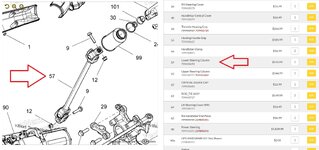

I have a new to me 2012 RT and am finding that the about a half inch of play in the steering is quite annoying. Do you have a part number for the steering shaft, and is this replacement part with the universal joints attached to the steering shaft, or are all 3 pieces all separate parts?
Is the play with or without the engine running? Check it both ways and see if there is any appreciable difference.
Most likely, you will need this part as it is the universal knuckles at both ends that wear out, giving you play in your steering.
