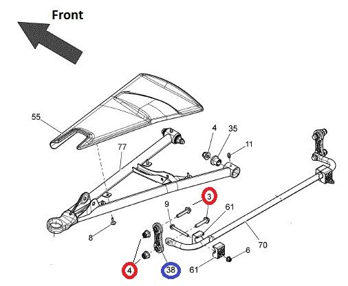

I am sold out of the Heim Joint Links. I cleaned out the supplier for the components and I cannot find anyone else that carries the same or comparable quality units. I could get lesser quality parts and they would probably work ok. But I just hate doing business that way.
The Heim Joint Links are extremely easy to install at any time. You remove Bolt #3 and Nut #4 (2 on each side), remove the old HJL (#38), insert the new HJL, replace the 2 nuts/bolts and you're done. You will have to raise the front of the Spyder enough to get under it.
I understand you're wanting to install the HJL's at the same time as the bar goes in. That makes sense. But it may be a few more weeks before I can get the links in stock.
If you have the recalled OEM composite plastic links (#4 with no paint dot) BRP will replace them at no charge. Those have been breaking with the stock sway bar.
