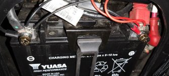

It's really easy to get to the battery to see if the wires are indeed hooked up.
While youre there make sure the connections are tight also.

The first thing you might consider doing is checking the battery terminal connections for cleanliness and tightness. Next thing would be to load test battery. replace if indicated by testing. If it starts fine, not likely to be a bad battery. Might want to just leave it on the maintainer for whatever time it takes to arrive @ a green light. These machines are sensitive to starting voltage, when they drop below ~12.5 volts while cranking all sorts of gremlins start appearing. My two cents FWIW

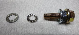

Also was the ignition completely off? Can give false readings otherwise. Checking connection & load test battery good annual maintenance at any rate. & if don’t have them, add star washers to terminals
Star washers……Had not thought of that. If they are not present, I will pick some up for this project. Thanks for the suggestion!!
