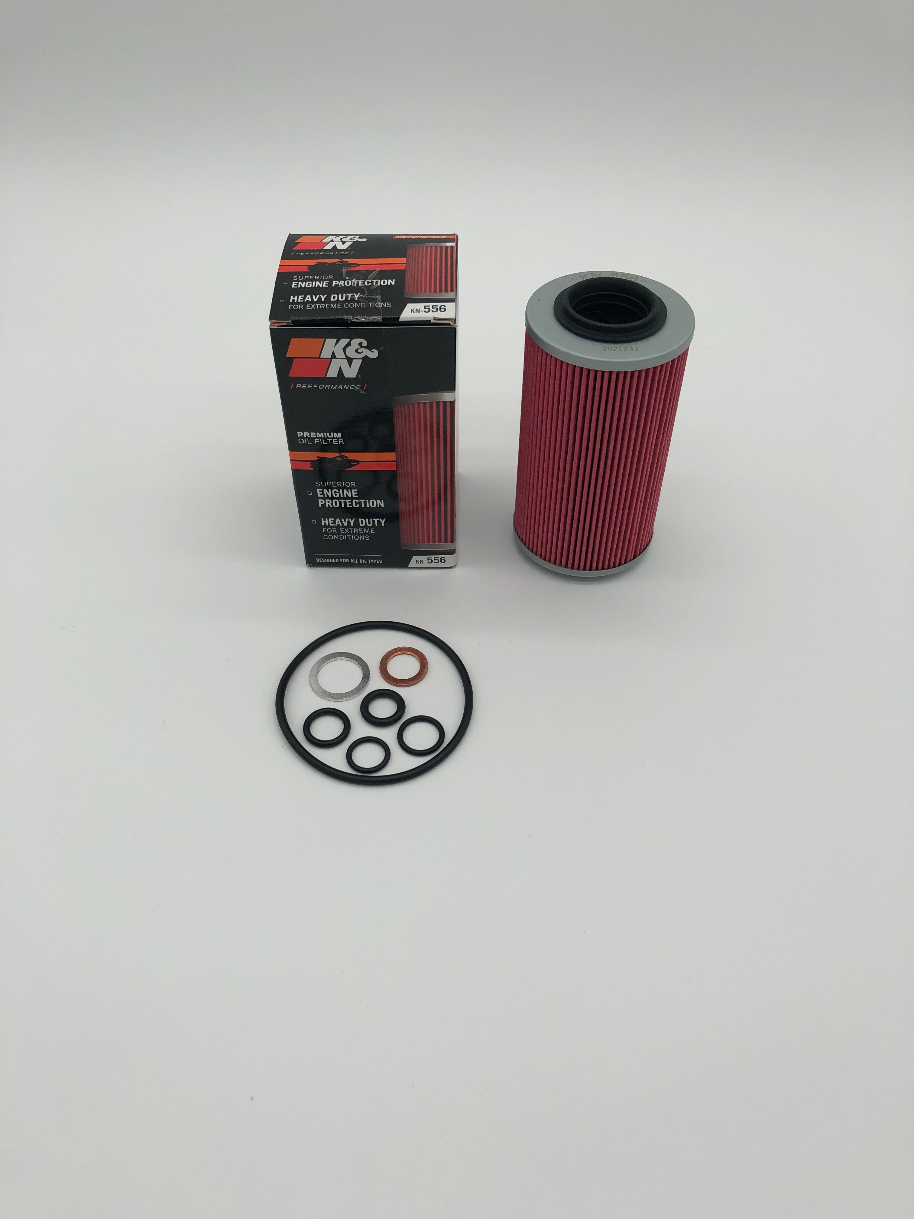

BAJA RON Has us covered on the 1330 oil filters
