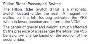

The "button" is only to lock a passenger seat on or other approved items. The left foot peg, when down, triggers a magnetic switch telling the Ryker to make adjustments accordingly for being "top heavy" with a passenger on board.

Magnetic switch, sensor... Potato/Potatoe. I can see the "switch" in a post where the gentleman removed the seat cover to expose the "sensor" and wires. This shows where the "switch" is located.

No peg, no magnet, no switch activation.
When there is no passenger lever installed, the computer can go into sport and rally modes.
When the lever is installed and it's in the upright condition, the computer can go into sport and rally mode.
When the lever is down, the switch over rides ( blocks) the computer from going into sport and rally mode.

Exactly. I understand the positioning. But, I guess, the question is, does it make physical contact with the switch, when in the down position?
Or, is it a magnetic switch, like someone else mentioned?

The switch is a magnetic reed switch and is installed and wired on every Ryker. The left passenger peg has a magnet that comes near the switch when the peg is down. It does not and has no need to make contact.
